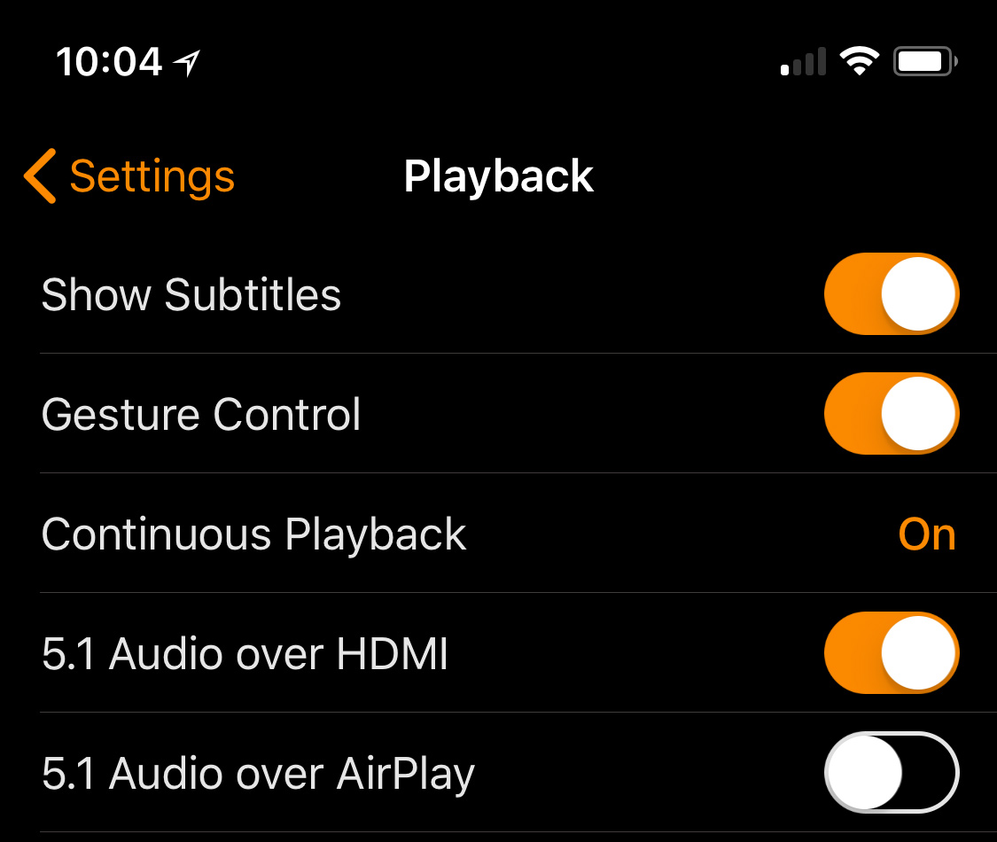

Option 2 - Disable 5.1 Audio over AirPlay in Infuse
The 5.1 Audio over AirPlay setting can be found in Infuse > Settings > Playback. Toggle this setting to off.
